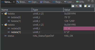

yes i did now. The code looks like this:
/* USER CODE BEGIN 2 */
uint8_t txdata[2];
uint8_t rxdata[2] = {0x00, 0x00};
HAL_StatusTypeDef status;
//first byte setting up the comm register.
//second byte writing to the mode register
txdata[0] = 0x01;
txdata[1] = 0x12;
HAL_GPIO_WritePin(SPI1_CS_GPIO_Port, SPI1_CS_Pin, 0);
status = HAL_SPI_TransmitReceive(&hspi1, txdata, rxdata, 2, 250);
HAL_GPIO_WritePin(SPI1_CS_GPIO_Port, SPI1_CS_Pin, 1);
txdata[0] = 0x4f; //read operation from id register (im setting the comm register)
txdata[1] = 0x80; //dummy data for response
/* USER CODE END 2 */
/* Infinite loop */
/* USER CODE BEGIN WHILE */
while (1)
status = HAL_SPI_TransmitReceive(&hspi1, txdata, rxdata, 2, 250); //rxdata[1] will be my chip id register value
HAL_Delay(10);
/* USER CODE END WHILE */
/* USER CODE BEGIN 3 */
/* USER CODE END 3 */
}The result:
rxdata[1] is still 0. Is there somehing else that i should try?

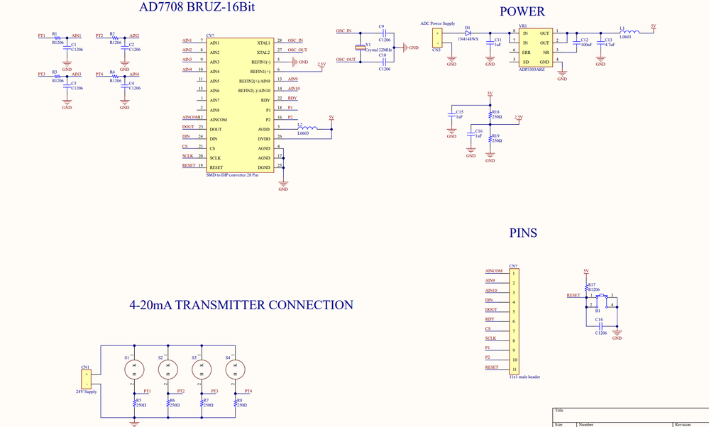

Here is the schematic
2024-02-08 5:38 AM
ok .
STM32 is a 3,3V system, so use also 3v3 on DVDD.
32k crystal running ?
C9 /10 = ?
2024-02-08 8:04 AM
yes 32k crystal is running. c9 and c10 22pF.
