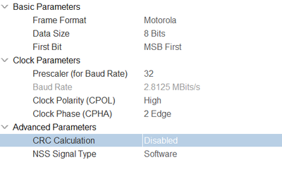

I examined it with the scope and i think there is no problem in MOSI line. But i cant see any signal in MISO line. Here is my spi settings in stm32cubeide.

So at first set the SPI signals , as this adc needs :
in Cube set : cpol hi + cpha 2 edge .
+ use HAL_SPI_TransmitReceive( ..) ;
+ how to set the command -- i hope you read the manual...
2024-02-08 1:36 AM
So i changed my spi settings:
and then like you sad i used TransmitRecieve func. but im not sure that use it correctly:
