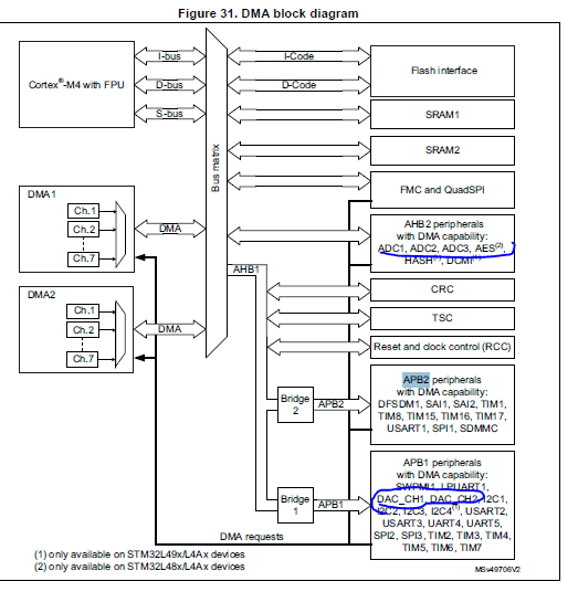

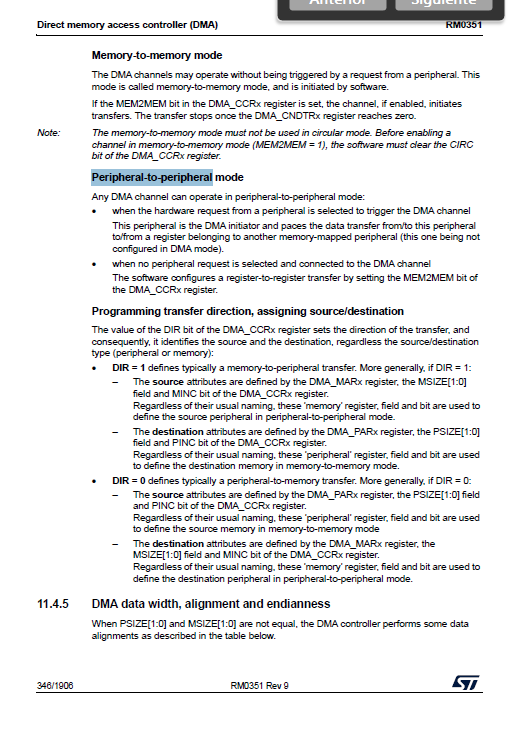

2022-10-21 1:54 AM
https://community.st.com/s/question/0D50X0000AnrIsfSQE/stm32f0-peripheral-to-peripheral-dma-transfer
Specifics:
This way you could get very fast data transfers and your Core is almost free to do whatever you want.
I just checked RM0351 and your MCU should support peripheral to peripheral DMA transfers
