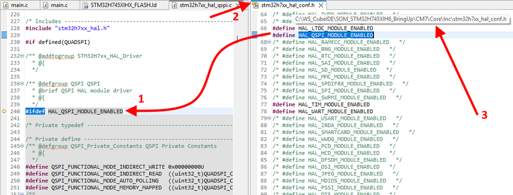

1 - HAL_QSPI_MODULE_ENABLED is defined and the shaded code areas are combiled. But I could not find why these codes seems shaded, do you ?
2, 3 - I can see file icon on the top left corner of the stm32h7xx_hal_conf.h file name and context menu shows absoulte path when mouse over while other files path seems relative to project directory. Do you know why ?

If you right-click on HAL_QSPI_MODULE_ENABLED (at line 240), and then Go To Definition (F3, or via Right-Click menu), does it take you to that definition in stm32h7xx_hal_conf.h ?

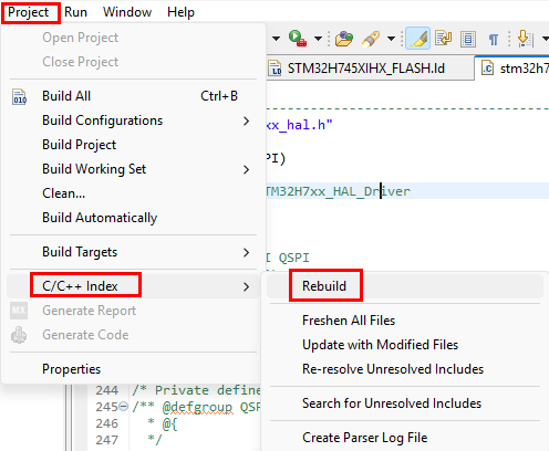

Have you tried rebuilding the Index ?

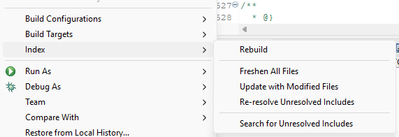

In the Project Context menu:

Thanks for prompt response. Rebuilding index solve the shading problem.
Prior to this operation, F3 was not working.

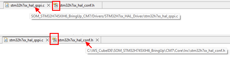

There is a file icon top left of the stm32h7xx_hal_conf.h file name, I do not know why is it ?
Also, when the mouse cursor over the file name, a path is shown in IDE, as you can see. The files without file icon path is relative to project but full path for the files without icon. I have tried with different file types. I wonder why ?
