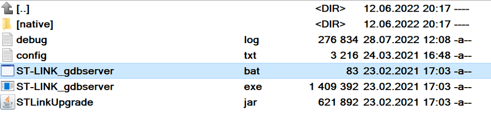

2022-11-03 6:52 AM
I'm not sure I can, out of that batch, make a running Renode instance start a gdb server.
Perhaps one can start a new renode instance with all the stuff needed, like loading a platform model, AND starting gdbserver... I'll look into that.
Is the ST-LINK_gdbserver _the_ thing that requires the HW debugger? Because, I set in the debug config to connect to a "remote server", which souns to me like it would not do anything with the ST-LINK_gdbserver.

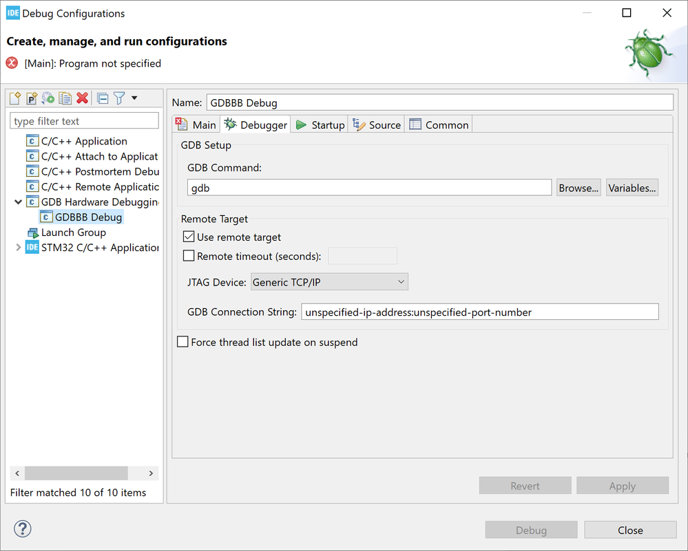

2022-11-03 3:36 PM
Ah, damn. Forgot about those other profile types.
I got farther with that, though I'm still doing something wrong w.r.t. starting the emulation at the right moment in all of this, or the .elf wasn't really loaded (Renode complained about PC/SP being 0), need to look into that more.
2022-11-03 4:59 PM
CubeIDE debugger has also OpenOCD option. It is opensource, you can hack it.

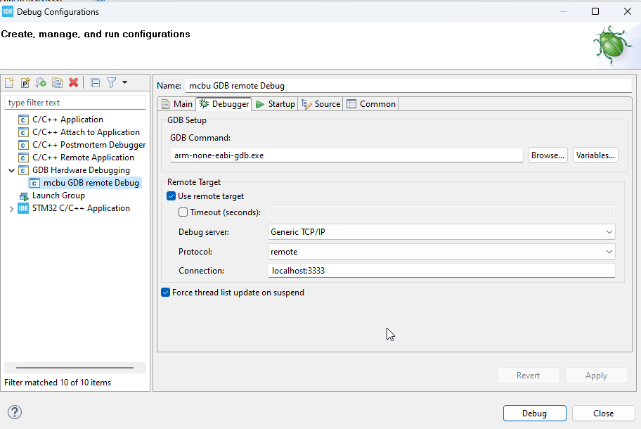

2024-03-07 12:21 AM - edited 2024-03-07 12:24 AM
With the hints provided by other users here in this thread, I got remote debugging of an application running on an emulated STM32 MCU in renode working:
Start the GDB server in the machine to listen on port 3333 (or any other unused port): (nucleo_l433rc_p) machine StartGdbServer 3333
In CubeIDE (v1.13.2) add a GDB Hardware Debug configuration like this:
