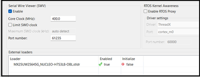

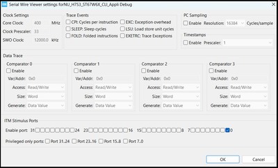

I am using STM32CubeIDE Version 1.19.0
[cid:f7b26411-0ca5-401c-aa64-aea0bfa68269]
[cid:f25e84a2-92d6-4c87-80ac-d9fe18753dae]
[cid:acca706a-2289-47a0-a749-1632afa7f2d6]
Can you clarify “newer STM32H7 need extra divisor for the core frequency”
Thanks Daniel
Daniel_Marosi
Associate II
IIRC the newer 'H7 (H72x/73x) have additional divisor for core clock -> ITM that does not exist in older series (H743/753...).
Current versions of CubeIDE and CubeProgrammer detect these MCUs and automatically apply the divisor, so users do not need to change anything in the ITM setup - just put there the core clock as usual.

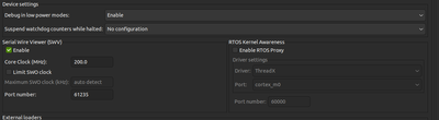

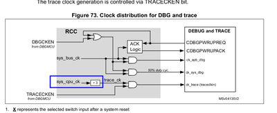

For my part, working on NUCLEO-H7S3L8 and using STM32CubeIDE Version: 1.16.1, I had to configure the SWV clock to a third of my core clock (configured at 600 Mhz):
I wonder if it has anything to do with the Debug peripheral clock divider:
Source
Thank  you Tahm_A
Fix Serial Wire View issue by setting SWV core clock to 200Mhz and SYSCLOCK to 600Mhz
