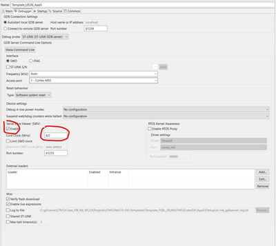

I have enabled Serial Wire Viewer (SWV) in my m55 application as I have done with my m4 and m33 projects, but the printf is not appearing in the SWV view.
Are there additional setup required on the NUCLEO-N657 board such as jumper settings or additional software setup?
Thank you.

@KDJEM.1 Thank you. Dividing the CPU clock by 8 resolved my issue.

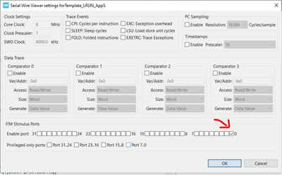

Could you please make sure that you:
- Enable TRACE CLOCK AND DEBUG CLOCK in DBGMCU register
- The SWV core clock in STM32CUBEIDE should always be CPU clock/8
- Configure the SWV ITM Data console

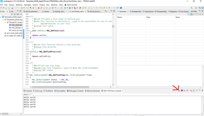

Below an code example of printf:
################CODE BEGIN####################
int __io_putchar(int ch)
ITM_SendChar(ch);
return(ch);
int main(void)
GPIO_InitTypeDef gpio_init;
DBGMCU->CR |=0x00300000;
ITM->TER |= 0x1;
ITM->TCR |= 0x00001;
//SWO is Ball U12 or PB5 label on N6
__HAL_RCC_GPIOB_CLK_ENABLE();
gpio_init.Mode = GPIO_MODE_AF_PP;
gpio_init.Pull = GPIO_PULLUP;
gpio_init.Speed = GPIO_SPEED_FREQ_HIGH;
gpio_init.Pin = GPIO_PIN_5;
gpio_init.Alternate = GPIO_AF0_TRACE;
HAL_GPIO_Init(GPIOB, &gpio_init);
HAL_Init();
/* Initialize LED1 */
BSP_LED_Init(LED_GREEN);
while (1)
/* Toggle LED1 every 500ms */
BSP_LED_Toggle(LED_GREEN);
HAL_Delay(500);
printf("Hello world\n");
################CODE END####################
