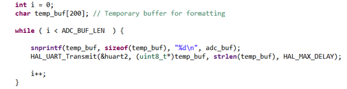

I want to send an array of integers over UART in one go. I was able to do this using for loop as below.
But I want to do it without for loop as it is taking time to send over UART. How to send the integer data over UART in one go?

I tried DMA also without for loop but I keep on getting address I guess but I am not sure.

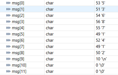

But again this will involve for loop as I have mentioned above and will take time to transmit.
Even if I tried to convert all the data into string; everytime only the first 8 indxes gets refresh; the other data doesn't append. So, I have to include the HAL Transmit function in for loop.
What is other way to transmit the integer without converting it to string and without the for loop?
