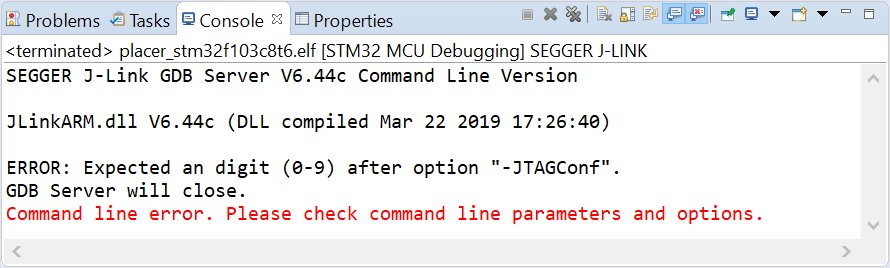

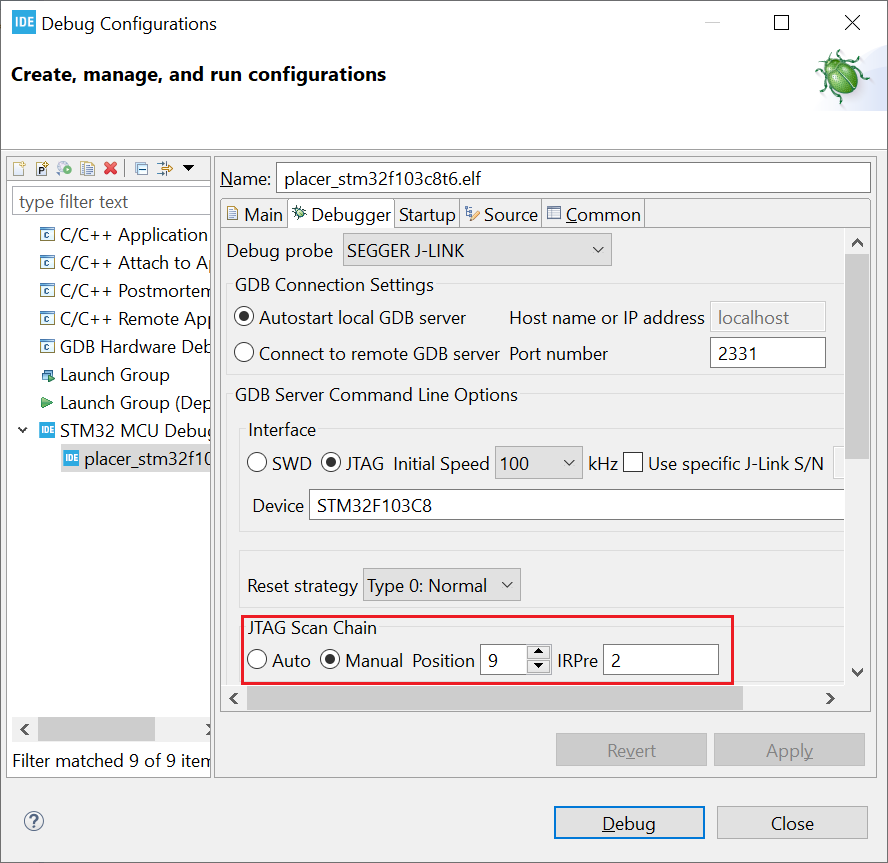

When I use -JTAGConf option like this
I get this
What should I do?
Thanks

I could use some additional information.
Could you try to start the Segger J-Link GDB Server manually with the option bytes required? And then post the results?
2019-07-04 3:32 AM
Yes, what should I do?
