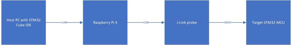

I am having issue debugging/ programming via STM32 Cube IDE with the J-Link probe (USB) connected to a remote host (TCP connection).

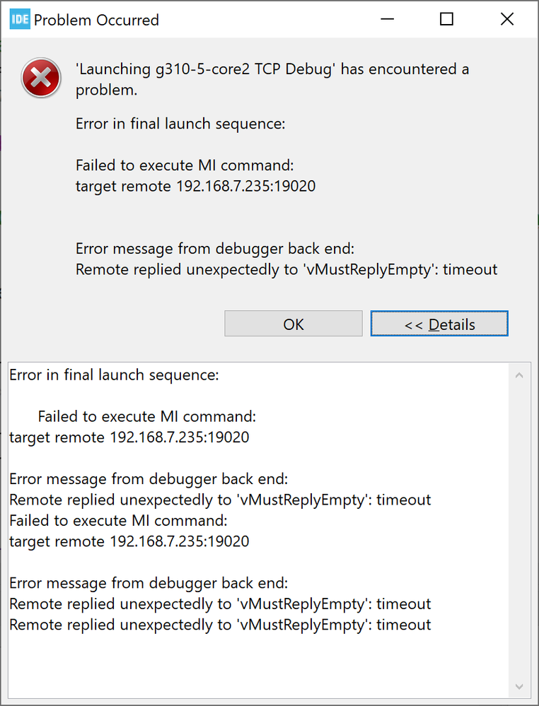

Whenever I am trying to debug/ program, the STM32 Cube IDE hangs for a while and eventually shows an error:

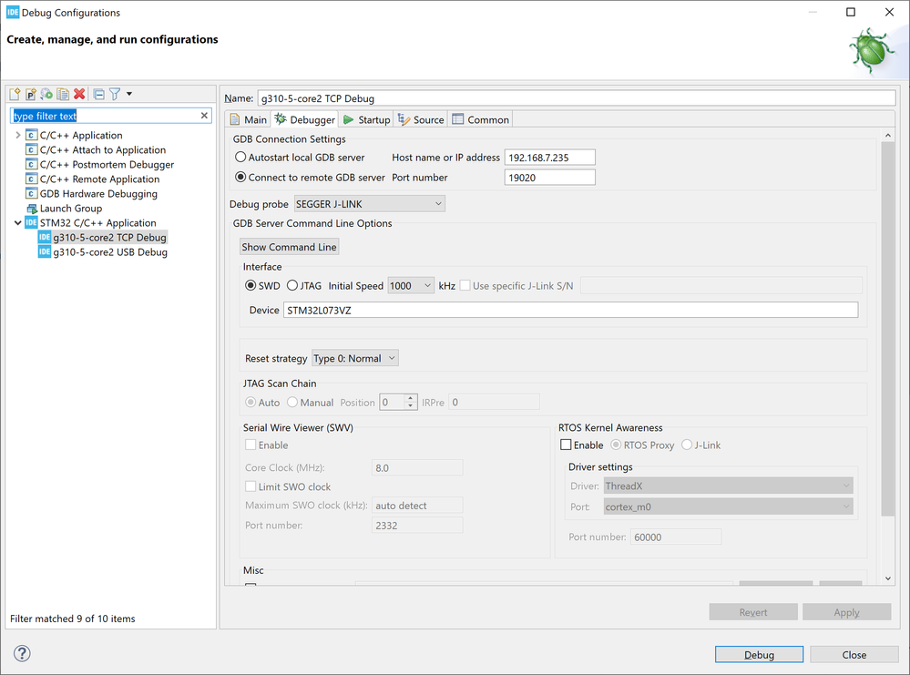

Conn. 8: Client connected.My debug config is:
Did anyone else experience a similar issue? I would appreciate all help!
