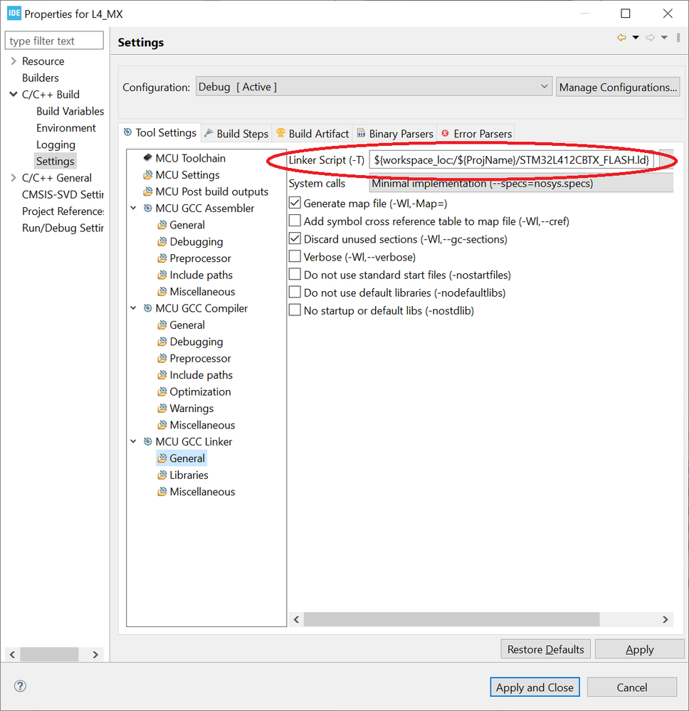

Markus GIRDLAND
Hello there,
I would try to check your build configuration and make sure that the path to the linker script is set up correctly.
The reason for the error is that the path that is written in the configuration contains variables that Eclipse resolves. If the string is empty after the variables have been resolved then the error is added to the makefile to make the user aware.
I'll attach a screenshot showing where the setting is:0693W00000LxgORQAZ.png
In my example I need to have a "STM32L412CBTX_FLASH.ld" in the root of my project, which is where it's located for me.
