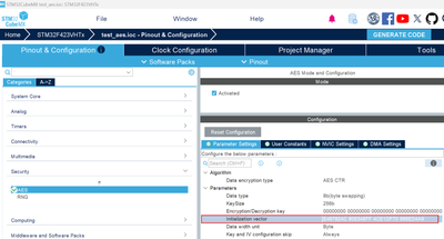

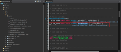

I'm facing an issue in CubeMX with the AES IV in CTR Mode
The IV is not saved in the IOC file and is discarded from the generated code, replaced with a full 0 value.
The AES content inside the IOC file:
AES.Algorithm=CRYP_AES_CTR
AES.DataType=CRYP_DATATYPE_8B
AES.DataWidthUnit=CRYP_DATAWIDTHUNIT_BYTE
AES.IPParameters=KeySize,DataType,DataWidthUnit,pKey,Algorithm
AES.KeySize=CRYP_KEYSIZE_256B
AES.pKey=-------- -------- -------- -------- -------- -------- -------- --------
MCU: STM32F423VHT
CubeMX: Latest version 6.16.1
AES Settings
Algorithm
Data encryption type AES CTR
Parameters
Data type 8b(byte swapping)
KeySize 256b
Encryption/Decryption key -------- -------- -------- -------- -------- -------- -------- --------
Initialization vector E467824C 805348FF 4CE1DF70 566ED4A9
Data width unit Byte
Key and IV configuration skip Always
