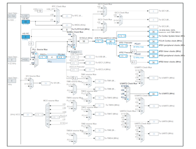

I’m prototyping on a Nucleo-F303RE using STM32CubeIDE. In the clock configuration, I set the system clock to 36 MHz from HSI (HSI → PLL with the /2 divider), as shown in the clock tree screenshot.
However, my firmware misbehaved. After debugging, I found that SystemClock_Config() function isn’t applying the HSI/2 divider when feeding the PLL. Instead of:
RCC_OscInitStruct.PLL.PLLSource = RCC_PLLSOURCE_HSI;CubeIDE generates:
RCC_OscInitStruct.PLL.PLLSource = RCC_PLLSOURCE_HSI_DIV2;
This effectively makes the system clock 72 MHz instead of the configured 36 MHz.
Did I misconfigure something in the clock setup, or is this a CubeIDE code-generation bug when using HSI with the PLL /2 divider?

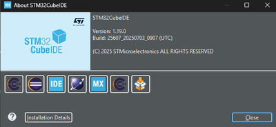

Hello @Bhavil
What is the version of the firmware and STM32CubeIDE used?
2025-08-29 2:19 AM
Hi @Souhaib MAZHOUD
I am currently on Version 1.19.0.
I am a little unsure, regarding the firmware version. Can you help me where I can find that?

Actually RCC_PLLSOURCE_HSI_DIV2 is not defined in stm32f303xe.h, Therefore, I suggest that you use HSI as input for PLL Source and Prediv /2 to address your clock configuration.
Meanwhile, this issue has been raised to the development team for analysis and revision of upcoming releases (Ticket 216974 This is an internal tracking number and is not accessible or usable by customers).)
