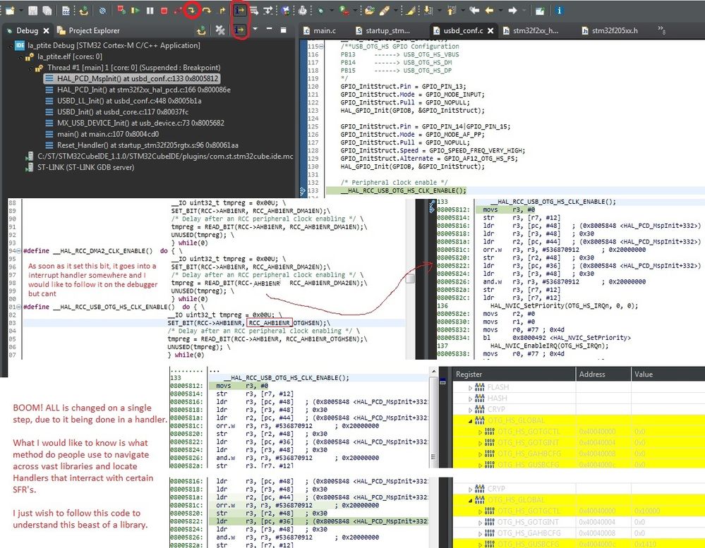

So I notice this uncomfortable feeling of not knowing WTF is going on when I single step through ALL the config, trying to make sense of all this BS stepping to setup the registers. Since most of this stuff I soon wont care about exept their 1 or 2 functions, but the USB I need to study a bit, yet when it gets to this peripheral, it sets it up in a Handler, and I cant see the relationship going between setup page and SFR's, wich I like to do.
How do people know where to check for Handlers. Now theres a handler but its lost somewhere...
I wanna see where this Interrupt is enabled for the USB clock in the first place, I know that as soon as the CLK bit is set it trips, but thats because its enabled.
I wanna practice and watch over the INTERRUPT ENABLE registers for such and such peripherals, is there there a "tree like" diagram for all the possible interrupt names and their peripherals for each family??

Anybody how I can watch my event handlers on STM32CUBEIDE ??
From this blogpost I cant understand.
