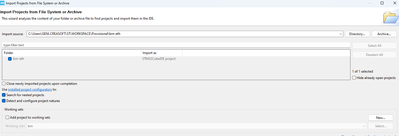

I tried the whole list of ways for opening a project: double click over the project file (nothing is happening), importing from file system, importing existing projects from workspace (with error message), open project from file system (nothing happens), etc..

Double click over project icon does not open anything and no message is launched. Click action is ignored. Same is happening when open project from file system option.
So I tried with importing a project: It also is ignored.
Hence, here I tried another thing: to create a folder and trying to import with "copy project files into workspace" option. So "tachan", it works.
I don't understand why the only way for opening this project is doing this "trick". This doesn't happen with the other projects I done with same package and for same mcu).
