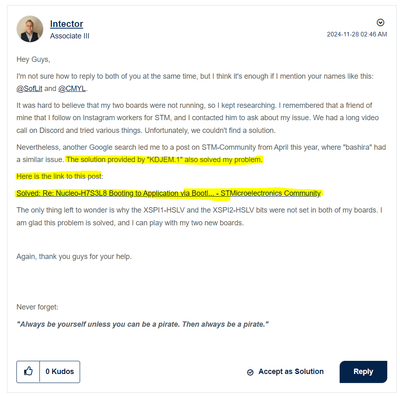

2025-01-12 1:23 PM
Hey,
sorry for the delay. Yew this solved my problem.
