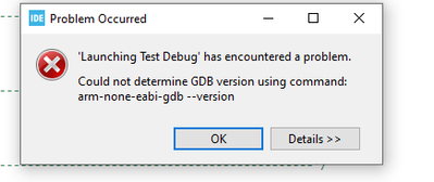

After an update i am not able to debug my program. I have already tried an new installation of the STMCubeIDE 1.12.0 but it still doesn't work. I've already tried to add a local toolchain in the Toolchain Manager, but the error still apears. Does anybody have an idea to solve this problem? :)

Hello @Stone1234
I suggests you to start by locating the GDB Server
It is possible that anti-virus software has either deleted gdb or prevented it from launching. Test 1&2 should be sufficient to tell you if this is true…
I will wait for your feedback.

Hello CHERNI,
thank you for the quick reply.
I executed the steps 1 & 2 and got this as the result from cmd:

Same here. It works once as soon as I restart STM32CubeIDE and plug the Nucleo board usb cable. Then it stops working. I've just updated the ST-Link firmware on the Nucleo board to latest version.

now I face the same problem with 1.13.1.
for my case, no problem last week, but met error in this week, so I tried clean install with new PC setup yesterday, and also get same error today on new PC.
Attached log file shows following activities..
