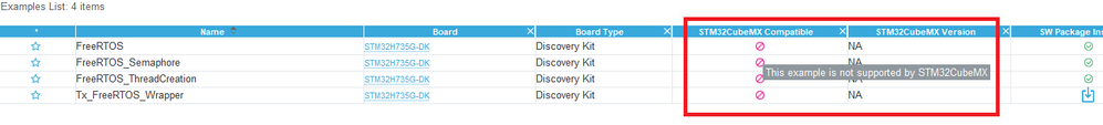

The FreeRTOS example from 'Example Selector' for STM32H735G-DK is not supported by STM32CubeMX.
You can start your project from scratch following the instructions to configure FreeRTOS in the section 4.4.15 FreeRTOS configuration panel, in the UM1718.
You can also refer to the working example available in the STM32CubeH7 MCU package:
\Projects\STM32H735G-DK\Applications\FreeRTOS
You can modify this working application depending on your needs.
