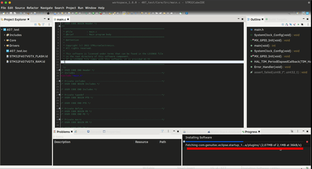

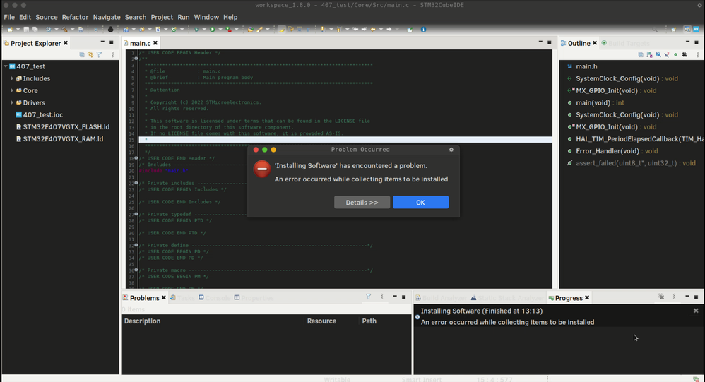

CubeIDE can't install Devstyle! Is it possible to install it manually?
If I'll download it from the official site and put it somewhere in CubeIDE?
Darkest Dark Theme with DevStyle https://marketplace.eclipse.org/content/darkest-dark-theme-devstyle
See screnshots!
The first screen is shown a second before the appearing of the download error.

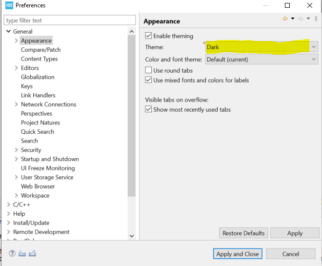

Hello @DK.7
In order to change the theme of CubeIDE to dark you can check this option under [Window]-> [Preferences].
Regards
Rim.
2022-11-23 7:40 AM
I had also experienced behaviour similar to yours, but after a few days everything suddenly worked, which indicates a problem with the delivering server, which is not related to STMicroelectronics. How long have you been trying (days, weeks)?
2022-11-23 7:42 AM
Thank you, Rim, for pointing that out. However, the built-in dark theme not only looks completely different from DevStyle, it also doesn't have the great features, such as a very nice search function.

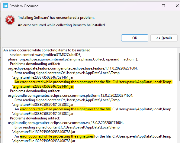

2022-11-23 12:56 PM
Confirmed here. The error seems to be in signatures.
My CubeIDE is v 1.7.0
2022-11-28 12:21 PM
I got answer from Eclipse.
Thank you for the details. We have a known issue with DevStyle installation on older versions of Eclipse. The dev team is looking into it.
I just tested DevStyle installation on STMCubeIDE 1.10.1 and it installs fine. You can give it a try on 1.10.1 and see how it works for you.
