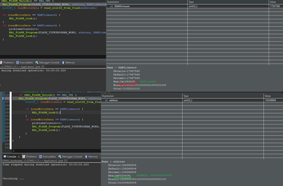

I compare the .bin file and .hex, data is the same.
I debug my program i I correct write data to flash (exmaple in screen).
But its not working maybe I do something wrong.
Maybe i should write data as little endian?
My first data line is:
:10 0000 00 00000320010902086D08020873080208 B5
Its ok when I write for example: (look screen of debug)
0x08020000: data: 0x00000320
0x08020004: data 0x01090208
etc.
2023-11-28 1:00 PM
Data in memory needs to be in the same order as in the file. The system is little endian so data should appear reversed when interpreting it as a uint32_t.
2023-11-28 1:38 PM - edited 2023-11-28 1:40 PM
Thanks for answer. You are best.
I want to understand correctly.
If I have first line:
Data is: 00000320 01090208 6D080208 73080208
Should I write like this?
0x08020000, data: 0x00000320
0x08020004, data: 0x01090208
0x08020008, data: 0x6D080208
0x0802000C, data: 0x73080208
2023-11-28 2:03 PM - edited 2023-11-28 2:04 PM
If "data" is a uint32_t, it should be reversed compared to what is shown in the hex file.
0x08020000, data: 0x20030000
Isn't this easily verified? Try one way, if it's reversed in memory, then reverse it before writing.
2023-11-29 11:00 AM
You are the best TDK :)
I wasn't sure, I had more problems, but your answer helped me - you have right.
Data in .hex file is Big Endian, and we have to change it to Little Endian.
