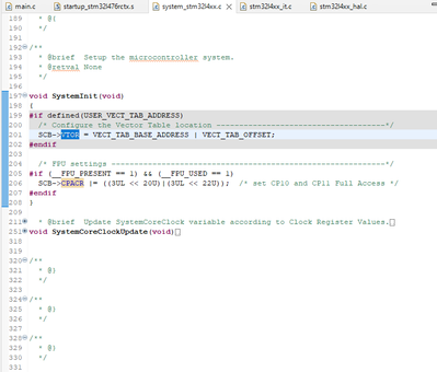

For the VTOR register, it's set in the void SystemInit(void).
An error in the system clock will cause the an error in the stack pointer values?
2023-11-27 10:04 PM - edited 2023-11-27 10:05 PM
Did you single-step through the SystemInit() code to verify that the VTOR gets set? Because it looks like your editor is showing you that the VTOR code is DISABLED (i.e. USER_VECT_TAB_ADDRESS is not defined). Notice how the VTOR code is grayed out, while the FPU code below is not.
