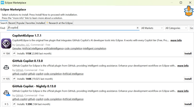

I am using Windows 11 Version 10.0.26200 Build 26200
2025-11-17 6:55 AM
Hello @NickO
Just to confirm, which version did you use exactly?
2025-11-17 7:00 AM
Just Copilot (I avoid nightly builds)
2025-11-17 7:03 AM
A new update to copilot has just come in. Completion seems to be working now.
