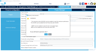

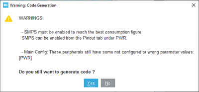

When using the .ioc to generate the code, it always shows:
- SMPS must be enabled to reach the best consumption figure. SMPS can be enabled from the Pinout tab under PWR
How to get rid of this? Or just omit it?
2024-07-19 9:57 PM - edited 2024-07-31 8:05 AM
Hello @diverger
Is just a message that contain some tips that may help the user to reduce consumption or in other cases to make the code work more Fluently or.... If you are not using them, you just have to omit them. But you can't disable them. If you find this helpful, I've escalated your request (in the internal ticket number 187848) to the Cube team so they may consider this recommendation to disable/enable those pop-ups in the coming releases.

2024-07-29 4:01 PM
Hi STTwo-32,
I'm using CubeMX 6.10.0 and try to configure STM32U575.
I keep getting this message and don't see any option to enable SMPS under PWR

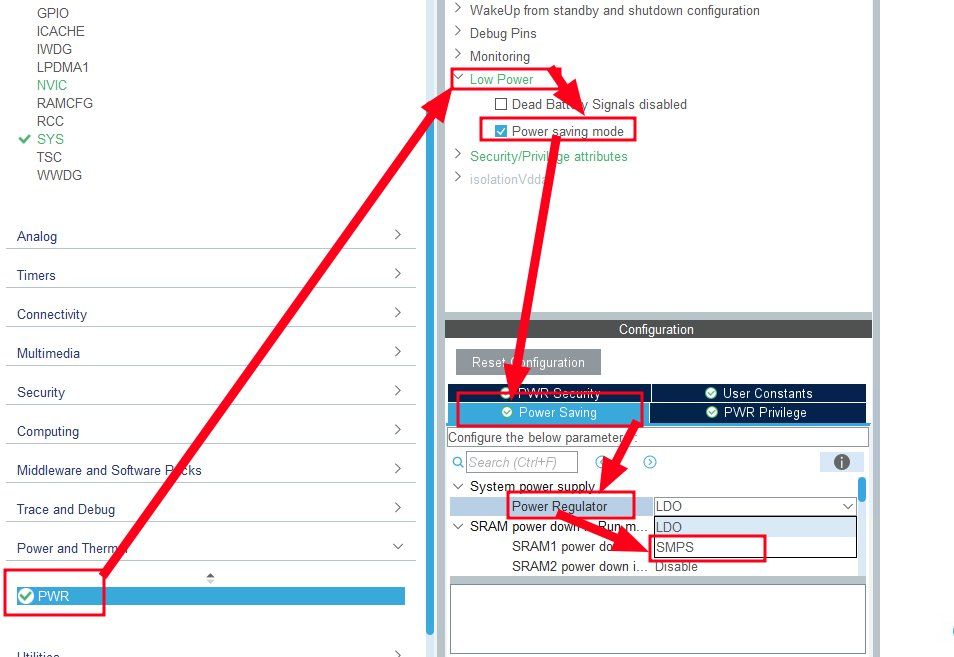

@Texram , there are two bugs here:
1. Cube gives you the warning about enabling the SMPS even for STM32U5 parts which do not contain an SMPS.
(can't reproduce this now, I must have confused projects with diff part numbers when checking this)
2. If the part does include an SMPS (part number includes a Q suffix), the UI buries the SMPS enable option 5 levels down:
Now that's some mighty terrible UX right there.
I've started this bug-report thread

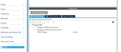

Hello @BarryWhit ,
Further to your comment, the SMPS is well removed from configuration of Power Saving Mode.
[ STM32U595xxxx] ; [STM32CubeMX 6.12.0]
We still have a waring Mentioned above.

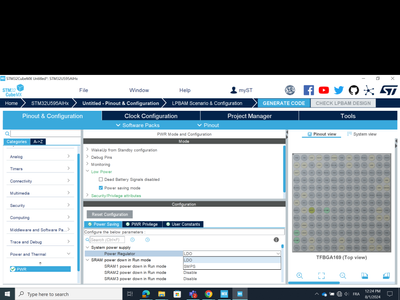

2024-08-01 4:33 AM
In System power supply, STM32CubeMX 6.9.2 gives the opportunity to choose between LDO and SMPS as power regulator in [ STM32U595xxxx] .
Knowing that STM32U595 MCU should not include SMPS and this issue was solved on STM32CubeMX 6.11.0.
The same topic has been mentioned through this Thread.
STM32CubeMX 6.9.2
STM32CubeMX 6.11.0
Thanks.
