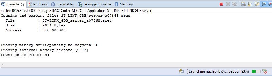

Currently, the status bar stops at 93% when downloading the software:

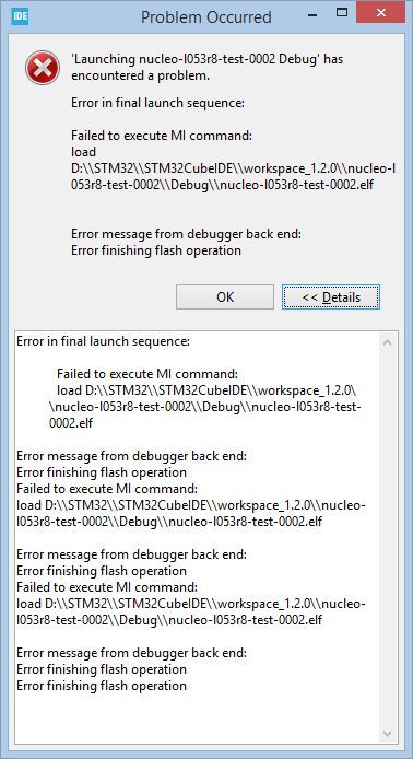

Probably after some timeout I get the following error message:

However ist getting even more weird! There was one small project I was able to upload from stm32cubeIDE, but only until I changed the code in main.c, forcing a new built of the project. From that time, I was no longer able to upload the code, it also stops at 93% now. Maybe anyone has an idea, what could be misconfigured?
