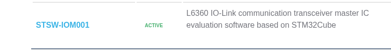

And what about the ->
You tried to use it ?
2025-08-22 10:57 AM
That’s my actual problem: I can’t import or build the example project and its directories
2025-08-22 11:41 AM
see:
So maybe you can use the source and copy the specific parts to a new project, you generate for the F401.
