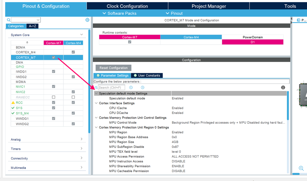

2023-06-09 1:56 PM - edited 2023-11-20 4:04 AM
They seem to be default values. You can enable the stuff in the visual configurator as the picture below shows but it adds extra functions: MPU_Config(), SCB_EnableICache(), SCB_EnableDCache().
