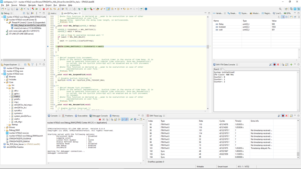

I start the debug session but the SWO data is incomprehensible. The other interesting thing is that after 1-2 seconds the data stream stops.
The test program printing the "System initialized!"-string after the hardware was initialized, then incrementing the value of a variable every 500ms and printing it.
I've included some screenshots of the issue:

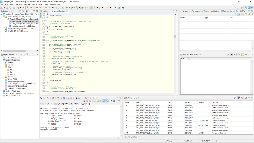

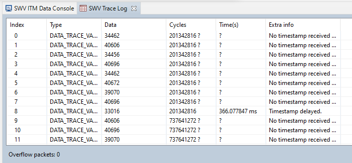

2021-03-01 5:50 AM
2021-03-02 1:58 AM
Does anyone have any ideas?
It's also weird that I only send data on channel 0 (printf), but other channel numbers appears in the log.

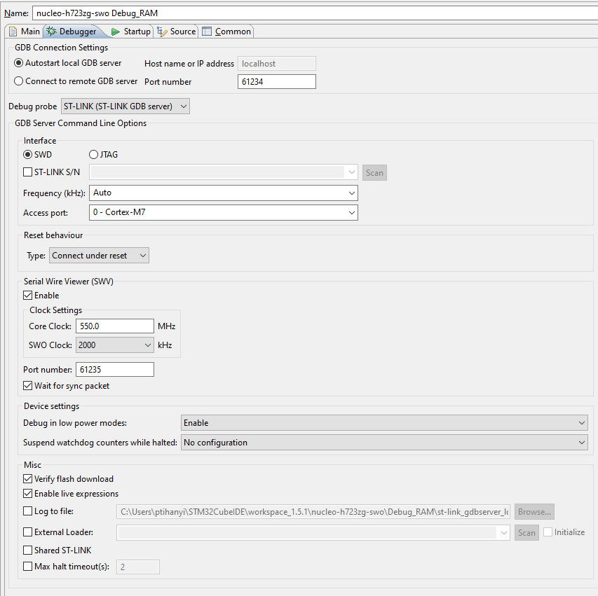

Then open the Debug configuration and in the Debugger Tab, do the following:
1) Verify the debug probe is set to ST-LINK (ST-LINK GDB server)
2) Verify the Interface is set to SWD
3) Verify Interface Frequency is set to Auto

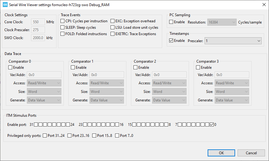

4) Verify Serial Wire Viewer (SWV) is Enabled (check box checked)
5) Verify Serial Wire Viewer (SWV) Core Clock is set to the same value as found in the CubeMX SYSCLK value
6) Verify Serial Wire Viewer (SWV) Limit SWO clock is checked
7) Verify Serial Wire Viewer (SWV) Maximum SWO clock (kHz) is set to 2000
8) Verify Misc Enable live expressions is checked
Once the Debugger is started:
1) Verify the Window->Show View->SWV ITM Data Console is selected
2) Click on Configure Trace (the tools icon)
3) Verify in ITM Stimulus Ports that Port 0 is checked (Enabled).

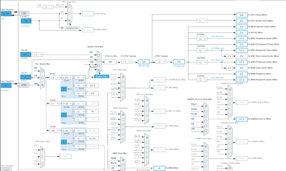

I am developing with the same board. After much trial and error, using the above tactics works, but only if you have the system clock at 550MHz and set the core clock of SWV to 275.0 MHz. If the system clock is set to another value and the SWV clock is set to half of the system clock, I just get gibberish from the printf(). If the System Clock is set back to 550 and the SWV is set to 275, it works. I had to add fflush(stdio) after printf() statements or would sometimes lose some characters.
If there is a solution to this, I would certainly like to know as I would like to use a System Clock of 528MHz or 480MHz.
