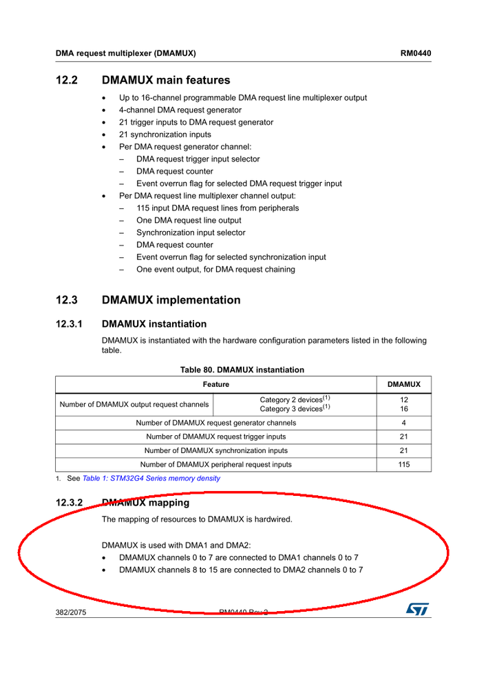

> The trick was to use DMA2, and the correct MUX entry (turns out DMAMUX1 channels 0-5 are only for DMA1 and 6-11 only for DMA2).
This clearly contradicts to RM0440:
Probably this info has to be split according to the cathegory of the devices.
@Imen DAHMEN can this please be fixed in RM0440.
@Vincent Onde in https://www.st.com/en/microcontrollers-microprocessors/STM32G431VB.html# folder I can't see any AN related to DMA, yet alone to DMAMUX, where this information ought to be detailed, too.

2020-03-26 1:22 AM
Hello Jan,
Thanks for your highlight. I put a request for changing RM0440.
Best Regards,
Imen
2020-04-27 4:42 AM
RM0440 Rev 4, is available with update and correction on "13.3.2 DMAMUX mapping" section following the feedback reported on this thread.
Thank you for your contribution.
