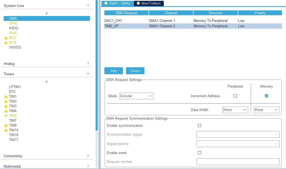

I want to DMA to GPIO and there doesn't appear to be any way to do this through the .ioc GUI interface. GPIO ports can't be targeted as a peripheral by the DMA interface, and when you select a MemToMem option in the DMA section, the code that is generated by STM32CubeIDE doesn't have any user sections, and is hence effectively not able to be edited by the user.
The other issue is that the MemToMem DMA option doesn't expose the most useful options like "circular" mode (it only exposes "normal") and doesn't give the option to provide any triggers either.
Have I hit the limits of what STM32CubeIDE is able to do already? or is there some way to achieve this through the STM32CubeIDE interface that I haven't yet seen?

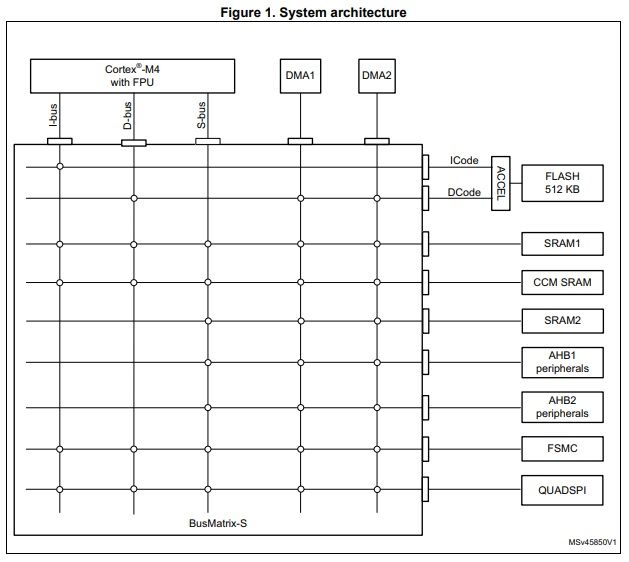

Luckily I'm using the Nucleo-STM32G431KB, so everything is able to connect to everything on this MCU's AHB bus.
I don't have restrictions about which DMA I can use it appears:

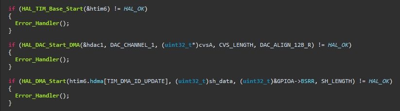

1.) Add DMA to TIM6 (which is also controlling a DAC simultaneously):

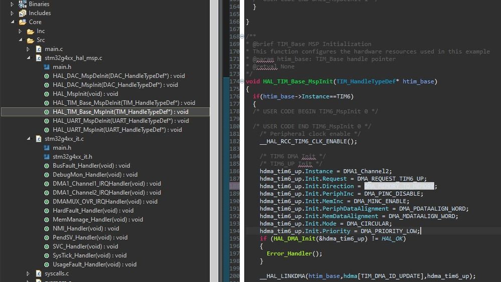

2.) Change the setting for the timer DMA in the auto-generated code to use DMA_MEMORY_TO_MEMORY rather than DMA_MEMORY_TO_PERIPHERAL:
3.) Start the transfer writing to GPIOA->BSRR:
And this frankenstein solution, which obvious gets nuked when you regenerate using a new .ioc due to modifying a generated function, ALMOST works.
I get one of the GPIOA pins changing, but at approx 3 times the rate I would expect.

P.S. it's quite frustrating that the interface gets SO CLOSE, but doesn't go the whole way.
Simply enabling:
1.) Circular DMA mode to the memtomem option.
2.) User-code sections for memtomem transfers selected from the interface.
Would allow so much more flexibility from the interface. I hope STM intends on extending the functionality rather than leaving it as an intro program to get people into the ecosystem. Since even for seasoned programmers a little extra functionality would make it infinitely more usable (and as you mention, more useful and complete documentation).

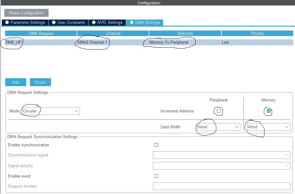

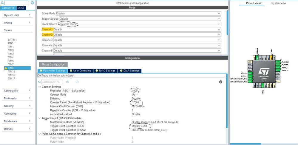

The basic setup of the project is as follows:
TIM8 set up as the timer:
DMA is set up to be triggered by TIM8 UP, in circular memory to peripheral mode:
The code is then extremely simple:
Start the timer (FWIW I've also tried HAL_TIM_BASE_Start and it makes no difference, still doesn't work):
if (HAL_TIM_Base_Start_IT(&htim8) != HAL_OK)
Error_Handler();
}Start the circular DMA transfer (Also tried HAL_DMA_Start_IT and it made no difference, still didn't work):
if (HAL_DMA_Start(&hdma_tim8_up, (uint32_t)gpio_data, (uint32_t)&GPIOA->BSRR, GPIO_DATA_LENGTH) != HAL_OK)
Error_Handler();
}Where we pass in the auto-generated DMA handle (hdma_tim8_up) and the data pointer (gpio_data) to the BSRR register for GPIOA output.
