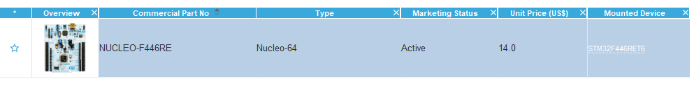

I have created a project with STM32CubeMx based on this evaluation board:
I generate the source code, and I can compile it correctly from STM32CubeIDE.

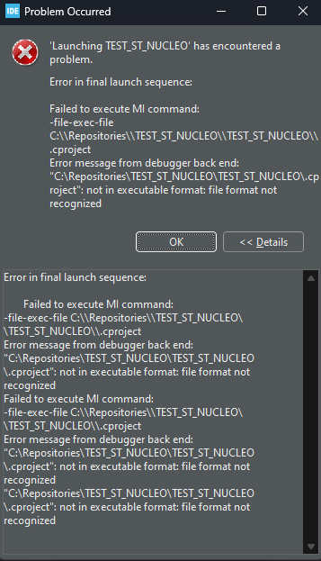

The problem is when I try to Run or Debug it, I get this message:
If anyone can help me I would appreciate it.

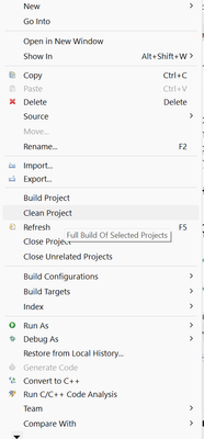

Let's try to clean and rebuild your project by following those steps:
In STM32CubeIDE : right click on your project and then clean project as shown below
Then rebuild your project , confirm that the build generates an .elf file
Finally launch your debug session.
THX

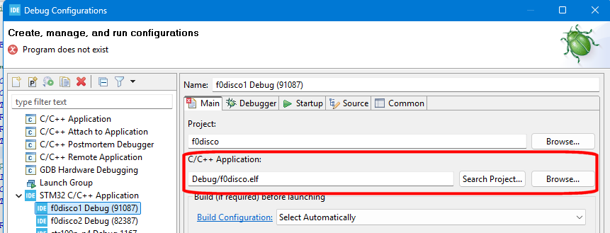

It looks like your Debug Configuration is wrong - it is trying to use .cproject as the executable.
The executable name should be <project-name>.elf
PS:
Like this:
