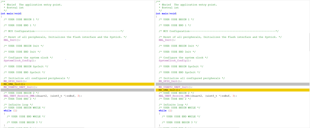

I have observed an issue with STM32CubeIDE v1.7.0 whereby the auto generated code is in the incorrect order for Uart DMA reception.
Below, I compare the generated main.c file from CubeMX v6.3.0 [Left] STM32CubeIDE v1.7.0 [Right] both using the firmware pack STM32FW_F4 V1.26.1
This issue was also reported and supposedly fixed in CubeMX.

This problem was answered at:
https://community.st.com/s/question/0D53W00000znZ7ZSAU/stm32cube-code-generator-bug-for-stm32g030j6
