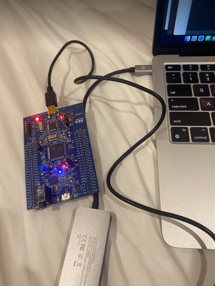

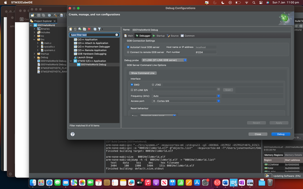

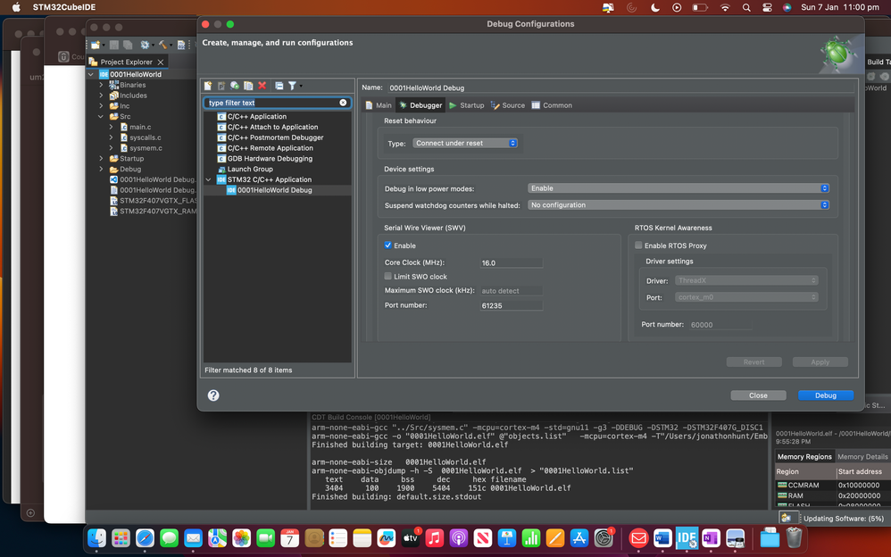

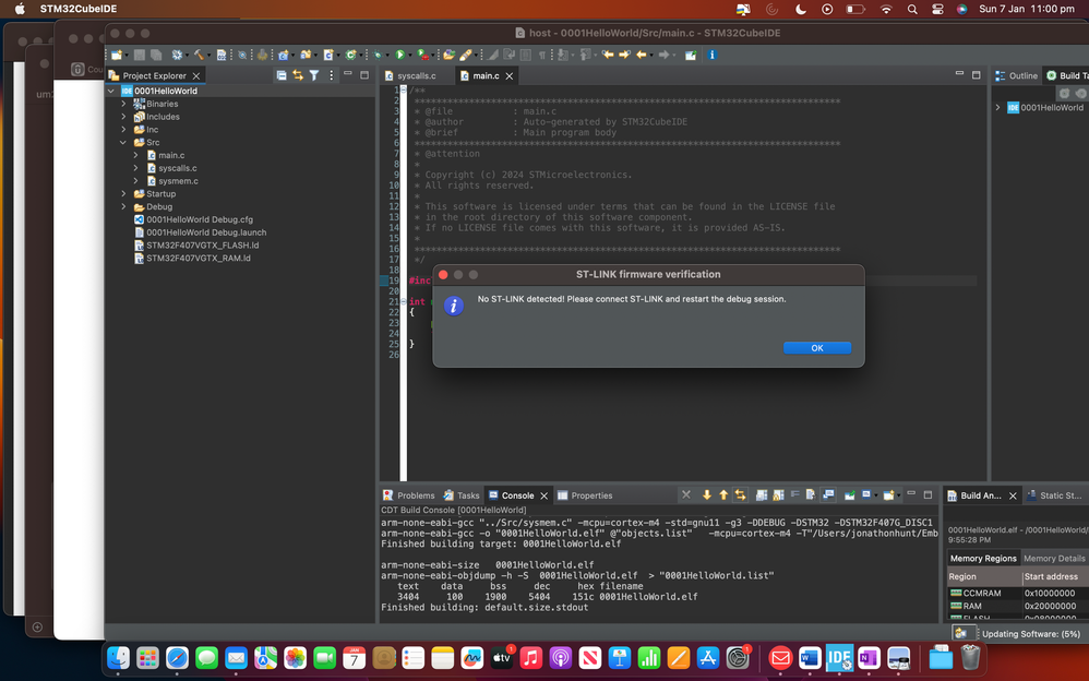

I have seen comments of similar regard with this issue, however I have not seen a way to solve the problem. When I try to debug my code and transmit it to my STM32F407G-DISC1 board it comes up with this "No ST-Link detected issue". I have attached photos, any help would be greatly appreciated.
2024-01-10 2:38 AM
What is the silver box at the bottom? Only a part of your setup is visible, so maybe there is still some error in your setup. Did youtry to connect the board direct to the PC?

2024-01-10 2:56 AM
Don't use Hubs or Docking Stations.
Make sure to use a Data Cable not a Charging Cable
