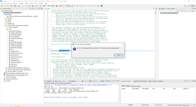

I downloaded FP-SNS-ALLMEMS2 to test sensors with STEVAL-STLKT01 and I installed STM32CubeIDE for the first time. I'm trying to test this project on STM32CubeIDE(Version: 1.17.0). But when I build and run, I get the message "No ST-LINK detected! Please connect ST-LINK and restart the debug session."
I tested both ST-LINK (OpenOCD) and ST-LINK (ST-LINK GDB server) in Debug Configuration, but they don't work. I don't know if it's a server problem or what's missing.

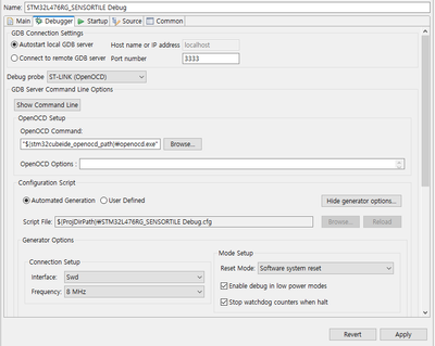

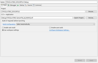

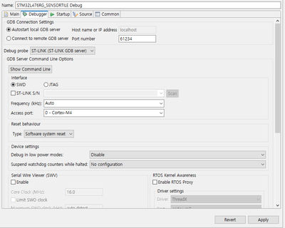

2024-12-26 3:14 AM
I've attached the setup below.

Try with debug option for selecting a certain st-link/SN , try: scan , to see what he can find.
You should see your st-link SN and fix it to use this.
