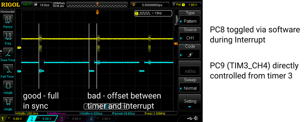

Using an oscilloscope on pins PC8 and PC9 is also possible. PC9 is configured as TIM3_CH4 and emits a 4us low pulse each cycle. PC8 is toggled for ~2us during interrupt. Trigger on rising edge of PC8 when PC9 is low.

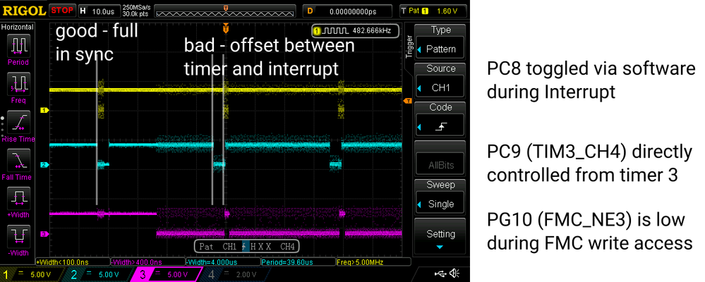

2023-04-01 6:33 AM
Please find attached a oscilloscope screenshot which also shows FMC_NE3. So The FMC is really executing the access. This was expected as we can talk to the externally connected IC without problems.
Interesting though, the FMC is still doing some data transfers after the timer interrupt was triggered. It seems like there is some kind of FIFO which has to be emptied before the timer interrupt is executed from internal memory.
2023-04-02 1:38 AM
The Cortex-M7 processor contains a 4-entry store buffer towards the AXI memory interface, which for Strongly-ordered memory area (and that's what you appear to have set in MPU for given FMC block) should behave as FIFO. From that scope waveform it's not quite clear if there are 4 writes to FMC between timer overflow and PC8 toggling or more. The ISR may be executing earlier, but the buffered writes may prevent the GPIO writes to be executed.
The Cortex-M7, with all the hundreds of megahertzs and caches and whatnot, optimized mostly for number crunching, is not that great for real-time operation.
2023-04-02 5:50 AM
Thanks so much for your help! Your explanations sounds very reasonable!
Sorry for the blurry screenshots. I've had a close look at the number of transfers done. It looks more like 5 or 6 transfers after the IRQ should be triggered, but beside that your explanation sounds very reasonable.
Additionally it looks indeed like you said: the interrupt might really be triggered immediately but has to wait for to access the GPIO.
