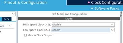

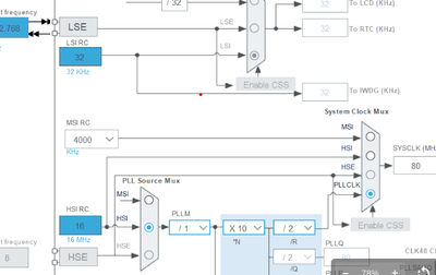

But you show the use of HSI :
+to disable the HSE and LSE : set it unused in Cube...

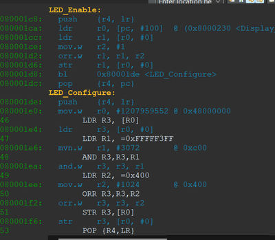

I did what you said, erased CPU memory then uploaded the program again. In debug mode and through disassembly, the program seems to be running from flash according to the adresses. But yeah... whenever I click on reset, no more blinking.... Thanks for your help, I'll ask my teacher once I'm back to school. I'll let you know if I find a solution.

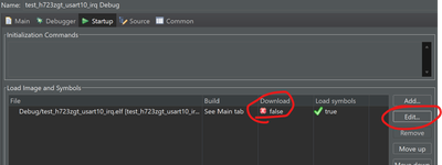

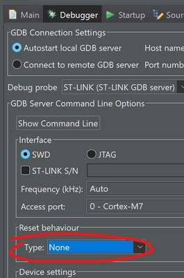

Modify your debug configuration not to reset or flash the chip with these two options:
and
Then, run your program until it gets into the stuck state, then attach the debugger. You'll be able to debug the current position of the code.
