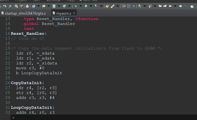

I found the solution. Some of lines (%function etc) you see here were removed. That's why things weren't working. Thank you all !

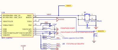

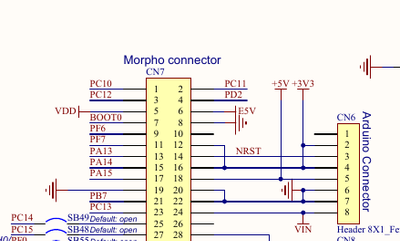

And > there was no "jumper" connecting it to the GND pin < : and now ?
so check: is boot0 at gnd ?
or just: put a jumper on cn7 , 7--8 , to have boot0 at gnd level.
It is with r33 to gnd , but maybe you damaged it and now its floating...
so:
- jumper cn7 , 7--8 .
- set cpu to use internal HSI
- set HSE unused, disable.
- check nrst is hi .
Then try flash...etc.

I have no extra jumpers, what I did was taking CN12's jumper and put it on CN7, 7--8, but things didnt work out.
