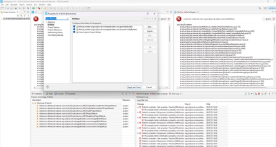

I am using the following setup:
- STMCubeIDE1.6.1 on Windows 11
I see the following behavior
- Opening the IDE with the default Toolchain and my Project for 1.6.1 works fine and build. However, I need to use the GNU Tools for STM32 (7-2018-q2-update)
- I install it with the Toolchain manager which works. Then I have to restart the IDE for the Toolchain to become active.
- After the restart the IDE is missing the usual C Project settings like Build C/C++ and the Toolchain manager. (see Image). Furthermore I get the 'Missing builder indication under the 'Builder' settting.
- Strange enough using this Toolchain works with newer IDE versions like v1.10.1 for other projects but I need to use v1.6.0 or v.1.6.1
- Only reinstalling the IDE can fix the issue.

2023-07-20 11:42 AM
If your toolchain works with IDE v 1.10.1, try to use this version.
2023-07-20 11:55 AM
Sorry I did not specify that. IDE v1.10.1 works with the toolchain for projects made for this version. My project requires version 1.6.1 or 1.6.0
2023-07-20 12:54 PM - edited 2023-07-22 4:43 AM
IDE 1.10.1 is only the GUI and builder. This should be very compatible with 1.6. The toolchain is already working well, as you wrote. If you want to edit and generate projects from .ioc files version 1.6, just install the standalone CubeMX of the same version. IDE v.1.10 can open eclipse projects generated with CubeMX 1.6.
Otherwise, a chance that outdated IDE version will be "fixed" is unlikely.

2025-05-11 2:50 PM
Could you provide a screenshot, as I don't have the Settings either. I'm using v18.1.
