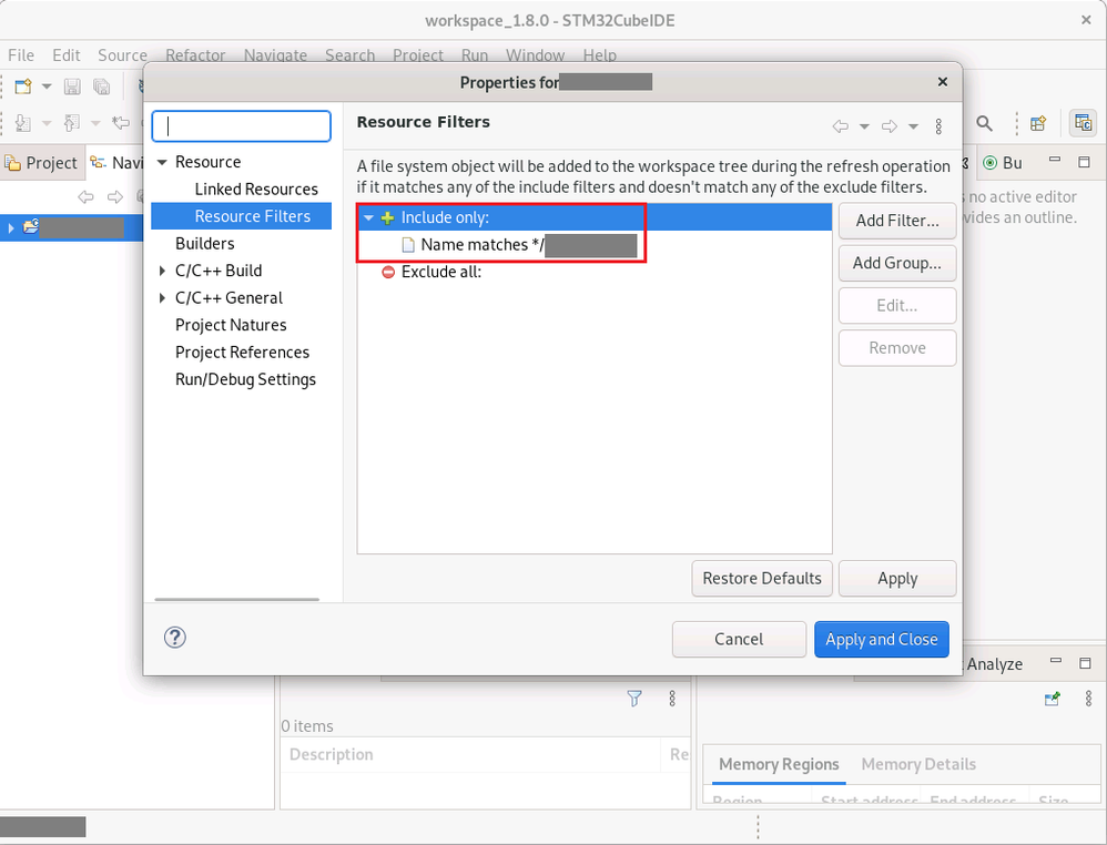

Your project is actually defining resources filters:
Means that .cproject file is present on disk but hidden from the IDE scope, so no chance for the converter to proceed.
To get the converter working I had to edit the .project file, remove all <filteredResources>[...]</filteredResources> stuff, and import the project again.
Hope this will resolve your issue too.
