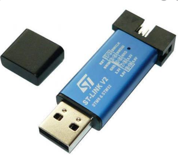

My debugger is one of these:

so called blue pill board. I don't know which NRST pin you are talking about, there is a RST pin on ST-Link, but I am not using it, only SWDIO, SWCLK, GND and 3.3V are used. BOOT0 jumper on blue pill board is on the "0" side, not 1.
