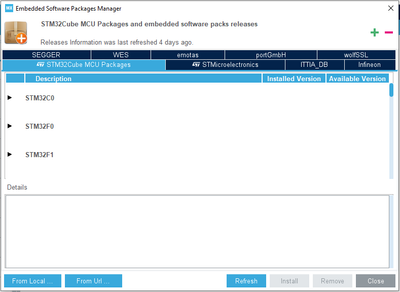

Ok not sure I understood the issue.
Do you mean when you want to select "Manage Software Packs" from "Software Packs" menu nothing happens?
In fact this window should show up:
2024-04-05 8:23 AM
Yes that is exactly what I mean
