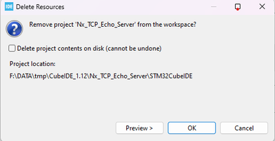

@ANauz.1 With all respect and sympathy, IMHO this was an important bit of experience with Eclipse and software in general. When you delete a project in Eclipse, it won't immediately nuke it! It will show a dialog like this:
A savvy user will think twice before checking in the "delete contents on disk' box... then leave it unchecked. Then  manually view & delete the files in explorer.  Reckless or curious folks will get what they deserve.
Also, talking about being professional - how about backups or version control for your valuable stuff? And er... manners?
Also, your scenario is not quite correct. With CubeIDE you create a CMake project. While CubeMX v. 6.10 (latest) cannot create CMake, it creates other types of projects (Eclipse, IAR etc. or plain makefile). These types of projects have different directory layouts.
/* EDIT */
Back to deleting a project: the preview dialog indeed is useless - it should list the items to be deleted. At least say "everything in that dir". The upstream eclipse should deal with this.
