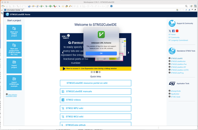

I tried a few things more, and found that if I click the STM32CubeMX link from the Information Center, I get a popup telling me 'This version of MacVim does not support "www.st.com" in its URL scheme'.
I do have MacVim installed. And I checked its URL Scheme in the registry. But it only registered the 'mvim:' url scheme, nothing else. I don't understand why STM32CubeIDE would use the 'mvim:' url scheme. It's probably coincidence that it used the MacVim URL Scheme, and it could probably have been any. But it surely must be a clue.
Note:
Checking the URL Scheme registry on macOS is not directly obvious, as it uses a 'hidden' tool. This is how you can list al the registered URL schemes from the zsh command line:
/System/Library/Frameworks/CoreServices.framework/Versions/A/Frameworks/LaunchServices.framework/Versions/A/Support/lsregister -dump URLSchemeBinding
