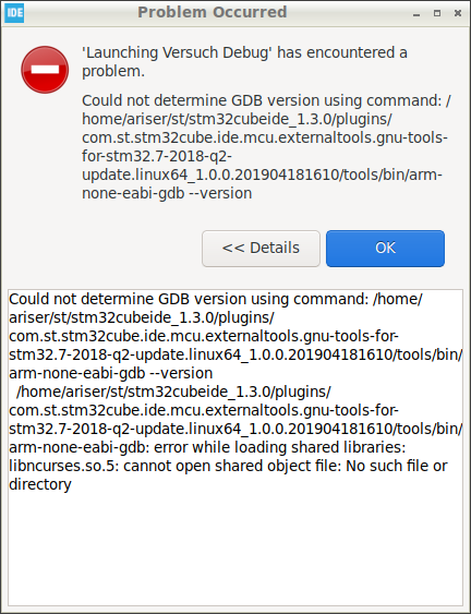

I ran into the well known problem with libncurses.5. My distro doesn't supply this old version of libncurses. Instead my distro supplies arm-none-eabi tools linked against libncurses.6.
I have two options:
Could not determine GDB version using command: /home/ariser/st/stm32cubeide_1.3.0/plugins/com.st.stm32cube.ide.mcu.externaltools.gnu-tools-for-stm32.7-2018-q2-update.linux64_1.0.0.201904181610/tools/bin/arm-none-eabi-gdb --version
/home/ariser/st/stm32cubeide_1.3.0/plugins/com.st.stm32cube.ide.mcu.externaltools.gnu-tools-for-stm32.7-2018-q2-update.linux64_1.0.0.201904181610/tools/bin/arm-none-eabi-gdb: error while loading shared libraries: libncurses.so.5: cannot open shared object file: No such file or directoryHow do I fix that problem?

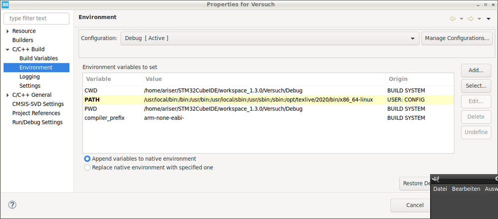

You can change the compiler by adding the path to the desired compiler in the PATH settings and remove the path to STM32CubeIDE's default compiler.
Project properties -> C/C++ Build -> Environment -> change PATH variable.
2020-06-08 1:26 PM
Path changed.
Error stays the same.
I restarted the program, I even did a reboot. Nothing changed.
What can I do next?
