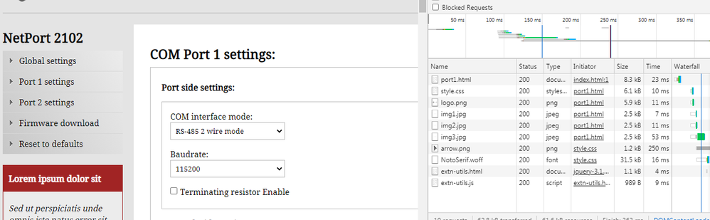

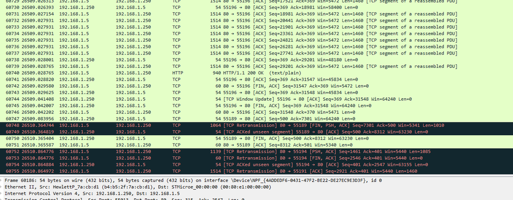

I'm trying to build http server based on LWIP on Nucleo F429 board. An example from Cube repository works fine, also with my custom http data and paths, which I have included in example project. But, another CubeIDE generated project with same or, even, greater settings in lwipopts.h works much slower and generate lot of packet retransmittions. I have checked all interrupts priorities in both projects, priorities of tasks, turn on lwip_stats, which shown absence of errors and so on. It's enough of memory and buffers. But have no result. There is the same problem on F746 DISCO. Please, indicate me direction for my eyes. Thank you in advance.

PBUF_POOL_SIZE too small and TCP acks were dropped?

My dynamic html page (chunked) 60kb in total (with font, images and scripts) loading 200-250ms without any retransmits.
