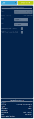

I then followed the Phils Lab tutorial https://www.youtube.com/watch?v=VlCYI2U-qyM to program the Nucleo development board using USB using STM32CubeProgrammer V2.17.
When I pull the boot pin high and press reset, it goes into boot mode, and the programmer detects it.
However, when I download the elf file, I get these errors:

After reading your comment, I just realised that I was trying to upload the .elf of the 64-pin H723 chip to the Nucleo board, which has 144 pins. I've tried a code generated with a .ioc file for the 144-pin version, and it now downloads, though it has no proper functionality apart from writing to Flash.
I tried to upload with the same method to an STM32H7A3 nucleo board with some code designed for that board. And it has the error for segment [2]
I've attached the .elf file as a .7z file to see if you have the same issue. I have changed some of the memory protection in the .ioc. I don't know if that changes it.
