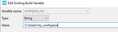

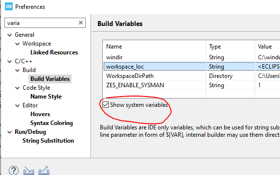

2024-10-24 7:12 AM
Variables are in [WIndow > Preferences]
and double click on variable. Still, need of double-click to see expanded variable. Could these be printed from e.g. Command line ?
