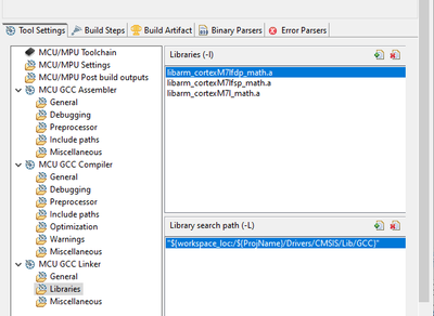

When I build my project in "Debug" mode all works fine, if I build the project in "Release" mode an error appears:
C:/ST/STM32CubeIDE_2.0.0/STM32CubeIDE/plugins/com.st.stm32cube.ide.mcu.externaltools.gnu-tools-for-stm32.13.3.rel1.win32_1.0.100.202509120712/tools/bin/../lib/gcc/arm-none-eabi/13.3.1/../../../../arm-none-eabi/bin/ld.exe: cannot find -llibarm_cortexM7lfdp_math.a: No such file or directory
GCC linker
Libraries (-l): libarm_cortexM7lfdp_math.a
Library search path (-L): "${workspace_loc:/${ProjName}/Drivers/CMSIS/Lib/GCC}"
Any help ?
Thank you

2025-12-30 6:52 AM
Thank you for your reply,
I set the configuration as "Release", then I insert the library name and the library path into the MCU GCC Linker -> Library
CarloV
2025-12-30 6:54 AM
CarloV

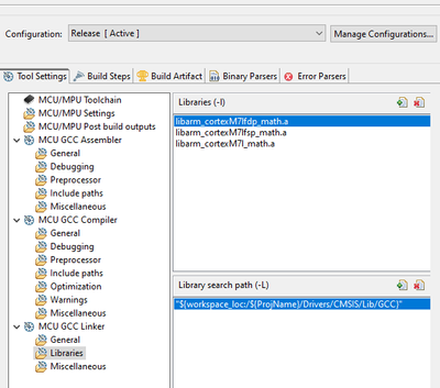

2025-12-30 6:56 AM
2025-12-30 6:58 AM
So, again, carefully compare & contrast the settings for the two configurations ("Debug" and "Release").
2025-12-30 7:07 AM
Ok,
they seem the same...what concerns the linker (GCC linker), there are no differences...do you think that I have to check other part of the setting ?
CarloV
