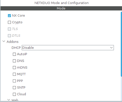

Now on H563 you have Azure RTOS , with can have FAT , sd-card, USB and network...
But if want freertos, ...tcp/ip - dont know, maybe look here:

2024-10-24 8:28 AM
I had the same issue. I was able to install it by going to middleware and clicking to install XCubeFreeRTOS. To enable it afterward, I clicked on it again and was brought to the Software Packs Component Selector. From there, you can click to expand everything under XCubeFreeRTOS (you have to click a few times), then select your desired TrustZone settings and which Heap you want to use. When that is done you can configure FreeRTOS
