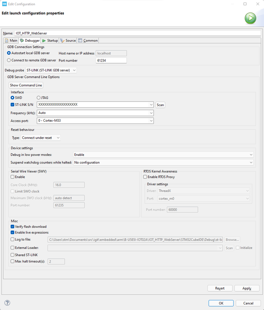

So assuming that this should work I tried to run or debug the IOT_HTTP_WebServer application by right-clicking the project in STM32CubeIDE Project Explorer and selecting "Debug as..." -> "STM32 Cortex-M C/C++ Application". In the "Edit launch configuration properties" dialog that pops up I leave all the default settings:
I can click on the ST-LINK S/N check box and click "Scan", and a serial number appears, so the connection appears to be working. I replaced the serial numbers manually with XXXXXX only for the screen shot.
When I then click ok I can see the the red LED next to the CN8 USB connector on the board flashes twice in green, and then an error message pops up with the text:
Error in final launch sequence:
Failed to start GDB server
Error in initializing ST-LINK device.
Reason: (0) Unknown. Please check power and cabling to target.
And in the Console view I see the following:

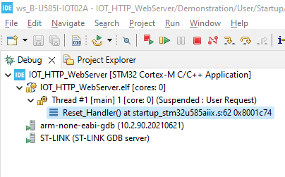

Thread #1 (Suspended : User Request)
Reset_Handler() at startup_stm32u585aiix.s:62 0x8001b80 When I resume the application, it continues for a few seconds and then STM32CubeIDE says the application has terminated, while the LED next to the CN8 USB connector keeps flashing in red and green.

After your reply I retried it, and after many more attempts I finally found out that I had caused the problem myself. When I start the Debug session, in the console view I get the message "Waiting for debugger connection" and while the program is uploaded the debugger shows that the program is suspended in the "Reset_Handler" function:
I always pressed the "Resume (F8)" button because I had thought that the program should continue until it is actually supposed to stop in the "main()" function, but exactly this caused the error in the debugger launch sequence. If I don't press the "Resume (F8)" button and simply wait, then after the program is successfully uploaded the program resumes automatically. Then it stops at the HAL_Init() function in main, and everything works as expected.
