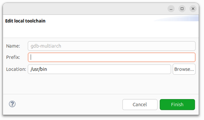

On Ubuntu 23.04 I encountered the same problem, but `libncurses5` cannot be installed anymore.
New Solution:
`sudo apt install gdb-multiarch`
And then go to "Window" -> "Preferences" -> "Toolchain Manager" -> "Add Local" and set it up like this:
Then "Set Default" on this new entry.
